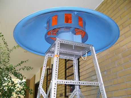

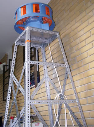

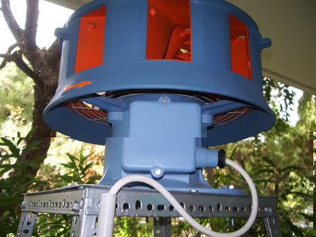

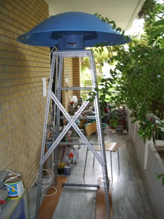

Hi!
finally my was mounted on the base. I had this DEXION base for many years. On it was sitting a self-constructed siren. Before installing the I had to make it more steady and robust in order to assure the safety of the siren, so I fixed a metal plate 2mm width on the top, and large wooden base plates.
Of course ... - the most important- I still have to connect it
