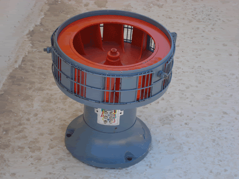

Edit: Concerning he slow start-up: Do you use the siren with a capacitor?
Yes! I used a capacitor because I don't have 3phase current. I know the use of capacitors reduces the motor power in the 80% of the original one... but I thought the start up to be too slow.

why don't you contact the FHF company? I'm pretty sure there are available spare roofs, and they can help you. I think they are still manufacturing this type.

Very interesting! thanks a lot, Niklas! I'll buy that capacitor as soon as possible, I think the owner of the shop is going to help me with the connection as always.
